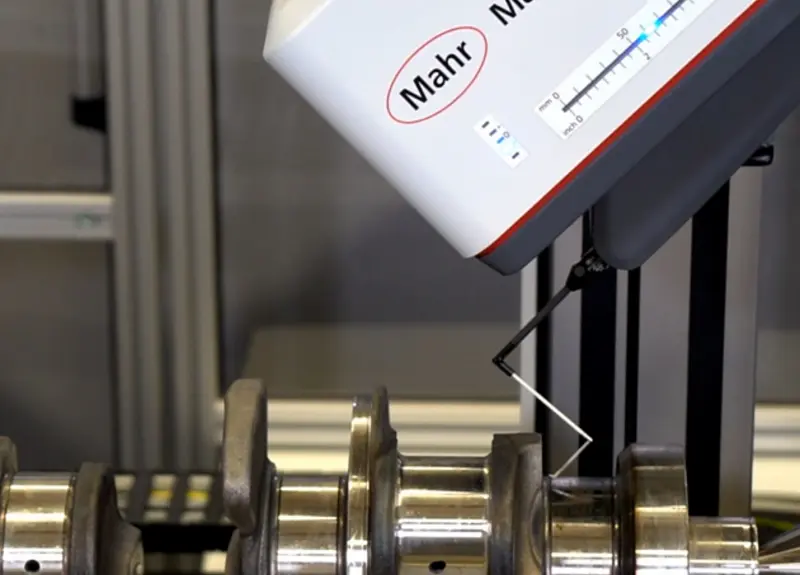

No. 2: Fully automated measuring station for production monitoring in manufacturing
The concept of this measuring station is characterized by a maximum degree of automation, with which Mahr sets the standard worldwide. The shop floor operator inserts the workpiece and starts the measurement. The operator can then leave the measuring station and pursue other tasks, as the measuring process is fully automatic without any further interaction.
This MarSurf Series 3200 measuring station is specially designed for the fully automatic measurement of roughness and contour features on large crankshafts and camshafts. The fully automatic process enables reliable and reproducible measurement results for complex and demanding measurement tasks without operator influence. It can also be used in everyday applications by personnel who are not trained in metrology. The feed unit is tilted +/- 45° during operation, minimizing the number of different clamping positions. The two holding prisms can be moved axially. This allows workpieces of different lengths to be inserted and then clamped between centers.
Functions of the fully automatic measuring station:
- Reliable and reproducible results
- For complex and demanding measuring tasks
- No operator influence, no personnel commitment
- Specially developed for large and heavy workpieces
- Use in production
