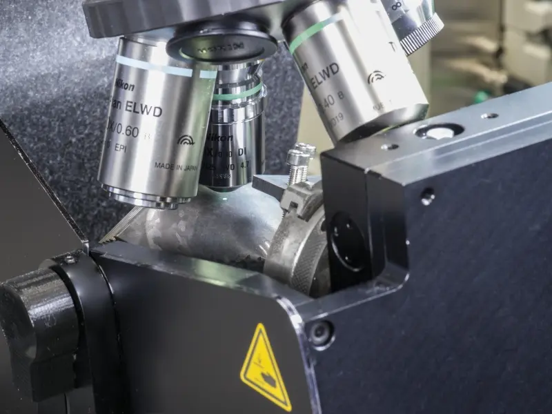

Turbine blades are mounted by their root in the turbine ring or turbine disk. This root is often designed as a "fir tree profile" because of the high centrifugal forces. These profiles are sanded and their surface quality has to be checked.
Measuring solution: non-contact optical testing technology

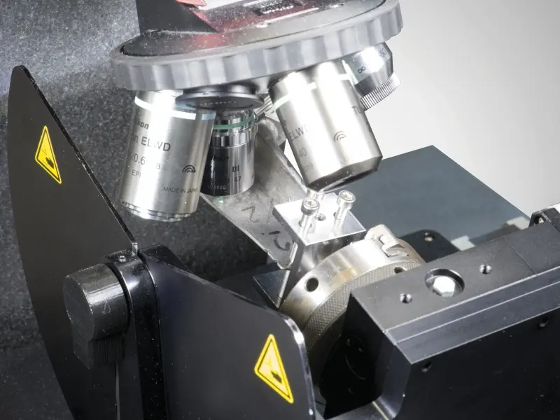

The MarSurf CWM 100 optical 3D measuring system operates as a confocal microscope and white light interferometer, allowing it to adapt to any surface microstructure. In this case, it is also possible to detect the various test points on the surface of the curved blade contactlessly with sub-nanometer resolution.

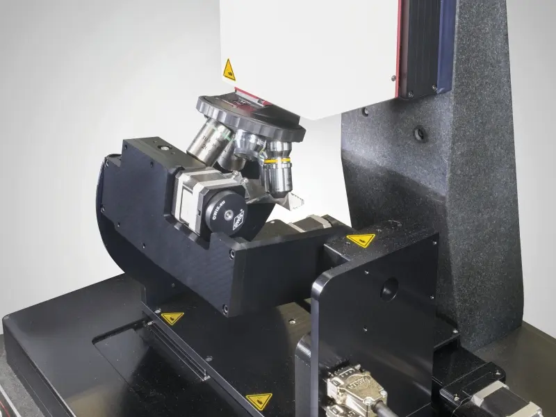

CNC-controlled tilt/swivel device

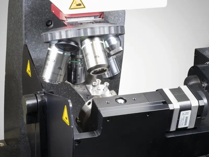

In microscopic measuring systems generally, an orthogonal alignment is required of the surface to be inspected with the optical axis of the lens. In practice, the complex geometry of turbine blades significantly complicates orthogonal alignment. For repetitive tests on identical workpieces, such a test can only be carried out sensibly with CNC-automated measuring stations. The MarSurf CWM 100 from Mahr with its CNC-controlled tilt/swivel device makes testing considerably easier. Due to the total of five degrees of freedom of the positioning axes, the point to be measured on the turbine blade can almost always be reached without difficulty – be it the blade surface itself, the edges of the blade or the outlet of the cooling canals.

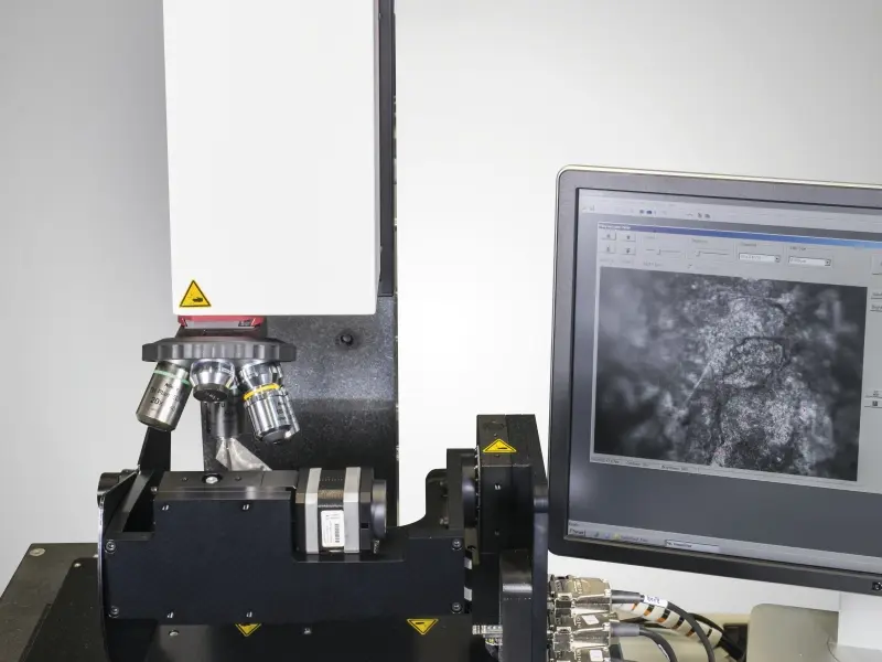

Fully automatic testing
The computer-controlled measuring system MarSurf CWM 100 with its CNC-controlled tilt/swivel device enables the fully automatic testing of the turbine blade. The measurement results are then evaluated by the high-performance MarSurf MfM software. Of course, this can also be done with an automatic tolerance evaluation, e.g. which also optically indicates whether the surface values are within or outside the tolerance.
