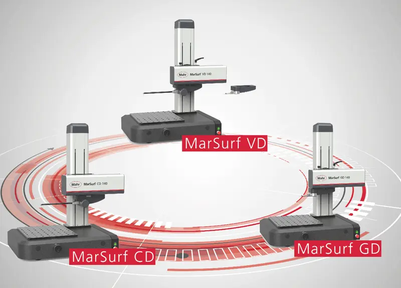

Get to know the series MarSurf CD, MarSurf GD and MarSurf VD now:
- MarSurf CD: Fast testing of contour
 - MarSurf GD: The new reference measuring stations for roughness and waviness
 - MarSurf VD: Contour and roughness measurement in just one system
All in all, the new MarSurf devices impress with their short measuring times, high flexibility and increased security for workpiece, machine and operator. For reliable and fast feedback on production, the measuring stations can also be used close to production.
