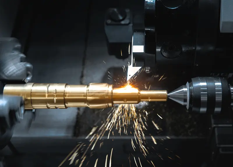

- Workpieces that have just come out of a dry machining process can be several degrees warmer and remain so for hours.
