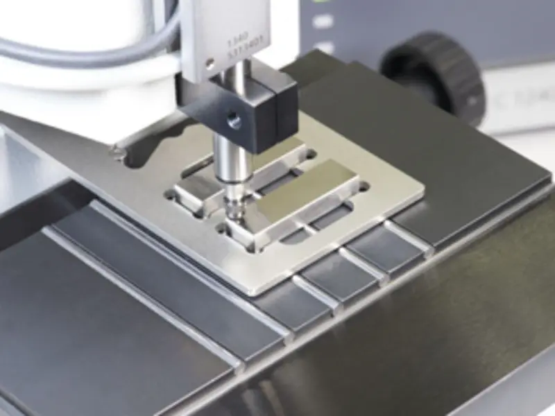

Easy measuring of gage blocks
The measurement of gage blocks with the very ergonomic measuring station is very easy:
- The test pieces and the reference gage block (standard) are placed behind each other the gage block holder on the gage block rest.
- The measuring table is designed with wear-resistant carbide metal strips, which allow a low-friction displacement of the gage blocks.
- The measurement is performed according to DIN EN ISO 3650: one measuring point on the standard and five measuring points on the parallel gage blocks to be tested are approached and measured one after the other.
