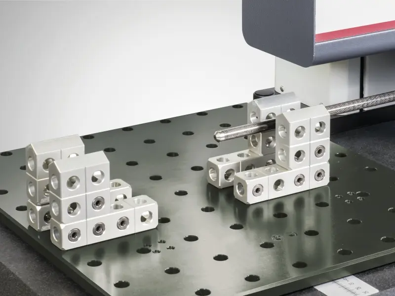

Contour measurement: The faster way to the measurement result – mount workpieces easily and flexibly
New freedom of measurement

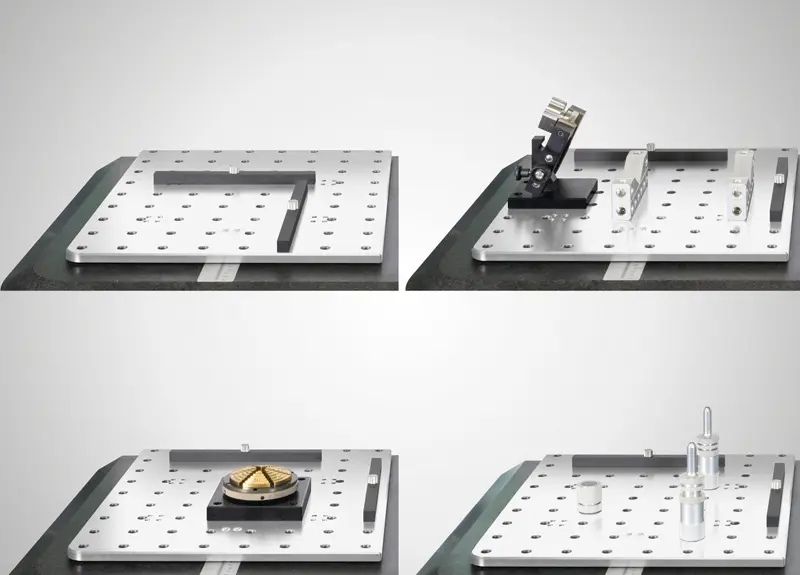

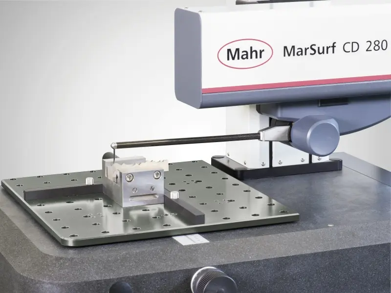

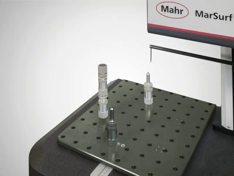

The rule of thumb for the quality assurance of workpieces is the fewer manual operations, the faster the measuring process. The key to this is provided by the innovative workpiece support plates on the new MarSurf CD 140 and MarSurf CD 280 contour measuring stations. The spacing of 50 mm and easily pluggable guide stops allow workpieces to be positioned flexibly and in a matter of seconds with just a few hand movements. Time-consuming fine adjustment is no longer necessary.
Large mounting plate makes XY table redundant
The mounting plate of 390 x 430 mm is significantly larger than conventional XY tables – making them redundant. A TY-adjustment of 60 mm is already integrated. Workpieces up to 90 kg are placed directly on the mounting plate.
Benefit: significant reduction in secondary processing times
- Position workpieces faster and with more flexibility
- Clamp workpieces more easily and reproducibly
Advantage: Measure workpieces more cost-effectively
- Check more workpieces
- Be much more efficient at the measuring station
- Measuring process will be even more reliable and economical overall
- React faster to new requirements
