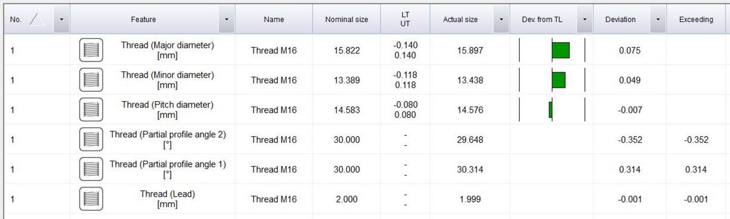

Using a cylinder AOI ("Area-Of-Interest"), the images are automatically recorded in several rotational positions. The inner or outer profile can then be determined from the images using the "Extract linear profile" function. "The necessary elements and intersections can now be calculated as usual on this derived profile and the usable thread length can be determined from this," summarizes Schlie.
It is also possible to measure the chamfer length and chamfer angle in this way, for example. In addition, MarWin EasyShaft also offers the option of determining thread parameters such as external, flank and core diameters as well as the pitch and flank angle.
