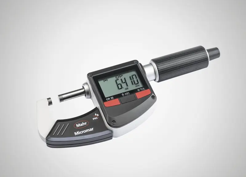

World novelty: Micrometer with radio transmission simplifies measuring
Measure more comfortably
The new digital micrometer Micromar 40 EWRi sets standards: The user measures decisively
- faster
- more easily
- and more reliably
Radio system "integrated wireless"
Measurement data is transferred to an i-Stick on a computer via the proven “integrated wireless” system – without any interfering data cables. The MarConnect interface provides the optimal connection. The micrometer confirms by means of a message on the display, whether the transmitted data was transferred correctly or whether the operator is in the receiving area of the i-Stick receiver.
European patent
Mahr has the European patent for integrated radio. Thanks to this patent and the innovative technology behind it, the measuring instrument is very compact and consumes very little energy.
User advantages
- Micromar 40 EWRi is the first digital micrometer with 10 mm digits on a contrast-rich display for safe and fatigue-free reading of the measured values.
- For the first time worldwide, it offers a comfortable tolerance display and additionally displays warning limits.
- In this way, the operator always recognizes whether the workpiece is within the tolerance limits.
- Measurements thus gain a higher reliability in quality assurance and expensive rejected parts are avoided.
- The manufacturing process becomes more efficient and process costs are optimized.
The zero position is set once
The reference system from Mahr makes the handling of the micrometer much more comfortable, since the zero position is set only once. This setting remains stored for all further measurements. This avoids erroneous operation. With the new "Hold" function (digital lock), measured values can be "frozen" on the push button and can be safely read off from a machine.
Exceeds the high requirements of DIN 863
The micrometer Micromar 40 EWRi is very precisely made and equipped with a state-of-the-art inductive measuring system. As a result, the measuring screw offers a precision that exceeds the high requirements of DIN 863.
Protection class IP65
Due to the high protection class IP65, the measuring medium is protected against dust, coolants and lubricants and is therefore ideally suited for use in difficult environments in the production and workshop.
